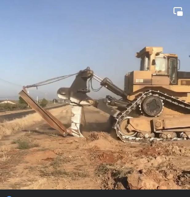

    If ya don’t have rocks one pass heaven gly , than this
