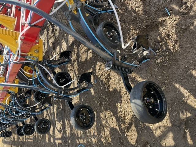

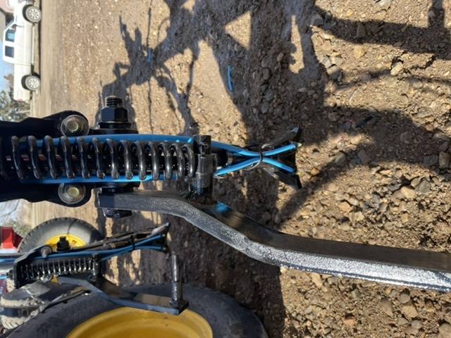

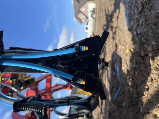

      Once we get these all set up I will post a few pictures.
      There will be a blue liquid phos line in each seed row . They have orffices and pressured for a steady stream.
      We do use it for canola once in while if needed , but the majority of canola is done with planter .
      We use Alpine G22 for the liquid phos , also can add dry phos through seed rows .

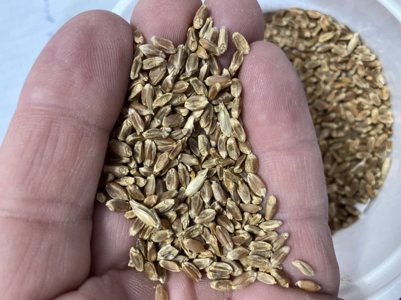

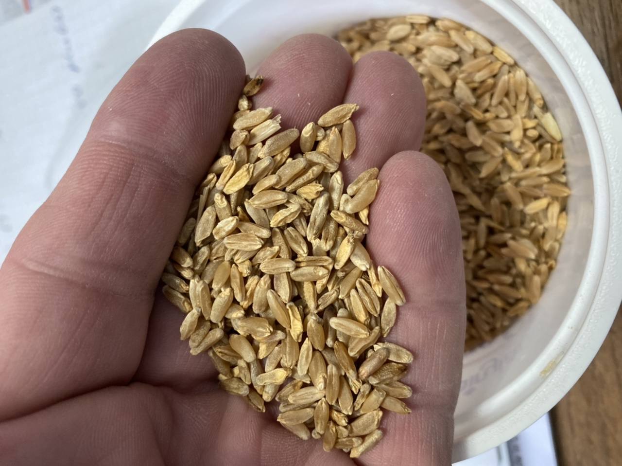

          i always keep a bin of wheat in case their is a disaster like that , recently cleaned 2020 wheat to plant this year
            • 7219
            We do similar but funny thing the frost year wheat germinated like a fool and so we cleaned up some 20000 bushels that we used for seed for 2003 and 2004 years but then were hit with frost in 2004 again that was a rough year. Cleaning Starbucks from last year will do 10000 bushels and have 5000 of Brandon and 5000 of Alida just in case.

                  interesting , will the liquid phos just dribble from the blue pipes behind opener ? i also use liquid but not for the phos , that is dry and goes down with the seed , but i would like to go all liquid , i have bourgault openers that are suposed put the 28-0-0 about an inch and a half to the side , works realy good on wheat , do you also seed your conola one pass with that setup ? i have been a bit scared to put 100 lbs N and the sulphur that near the seed , also i dont think the fert is put deep enough seeding conola that way , so i band all the N and sulphur before seeding
                    that looks a neat setup , so the seed goes in two rows with the N deeper in the middle ? what spacing is your drill ? is that shank mounted packers i see too ? sorry for all the questions !
                      • 22632
                      Yes paired row seed , 12 in space
                      N in centre
                      Yes shank mounted K Hart packers
