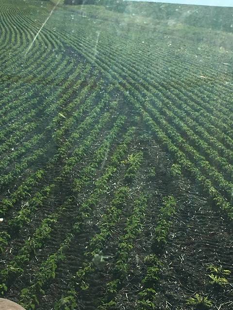

    Individual seed row shut off .
    Wow furrow,,, seeing that seed single row shutoff, that's beautiful !
    Is it that neat at 7.5mph? or would you have slowed down some, to get it that accurate?
        When it works is that accurate up to 10 mph
        We had a little trouble a few years ago but it was computer / gps related .
        Again the smaller the seed size the less exact it will be . At 6 tkw it’s nearly bang on as long as your GPS and monitor are synced good

                Just a couple pics
