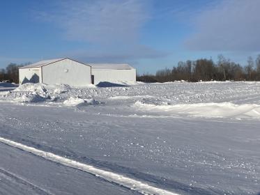

            We hauled in 20 (19 yds) loads of fill
            Goodon built 48’x60’ x18’ pole shed shop totally finished with 26’ bifold in 4 days
            They left 16 ‘ overhead door and blown in insulation in attic for a local contractor , whom they paid
            Soon as that door was on we got floor poured
            Better this way cause you can control environment for drying cement
            We let cement go right to outside treated 2”x8” bottom strap (which also has a styrofoam strip on inside of strapping, and also pounded 6” spikes a couple inches into treated poles on three sides thinkin it would help keep poles and cement the same height ? Poles are in 5’ , she’s tough ground here
            Very happy with everything 4.5 yrs later

                Worked out 5.5” of the highest psi cement
                24” under doors , rebar every sq ft
                More under doors
                Only cracks are where saw cuts end at walls
                Very nice job
