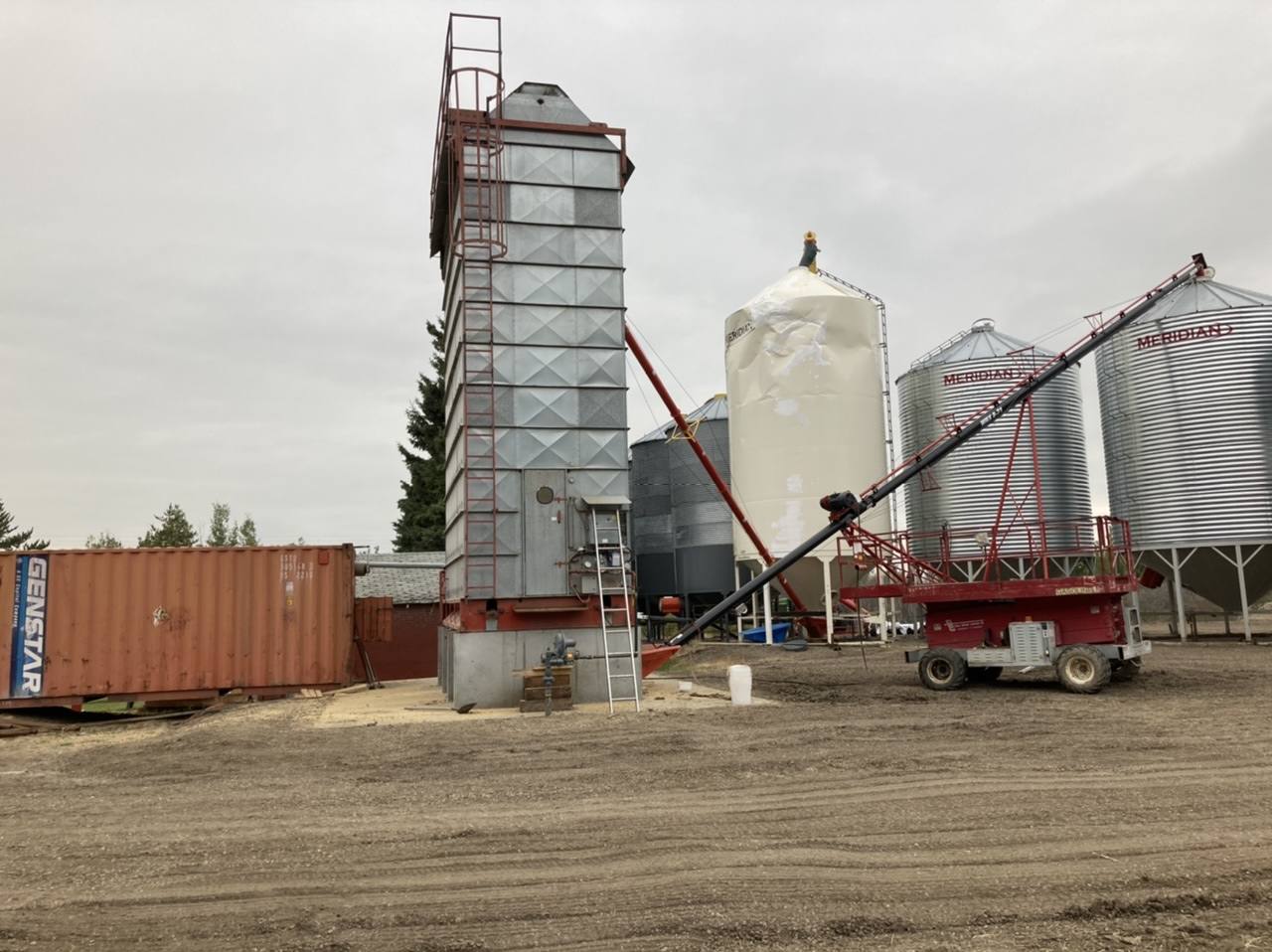

          Flea beetle
          I would recommend looking at a dryer to speed things along. Set one up that’s easy to use and start threshing earlier. Our season out west in the bush is short at best and I believe it’s the only way to go. When your temps are nice in September the cost of gas is a fraction compared to December. I realize it means handling the grain once more but the extra days it buys is priceless.
          We put up this used dryer last year for under $120k and it’ll easily do 800 bph at 5% with minimal babysitting. That cost includes the gas hookup, concrete, diesel genset, new dry auger, and the dryer.
          The bins were here already and it’s paid for itself already. When you have 30% canola in the field and snow coming shortly it’s go time. Just gotta clean out the wet bin daily so it don’t start heating. Better than adding another combine in my eyes.

                      #60
                      Flea beetle
                      I have a neco 1680. A little smaller dryer than what you have. Probably 500 bph at 5%. I guess I should utilize it more in early harvest like you say.
                      I just can’t bring myself to do it unless I absolutely have to. Always say in my head, in three days it will be dry. But I guess that is 3 days of combining!
