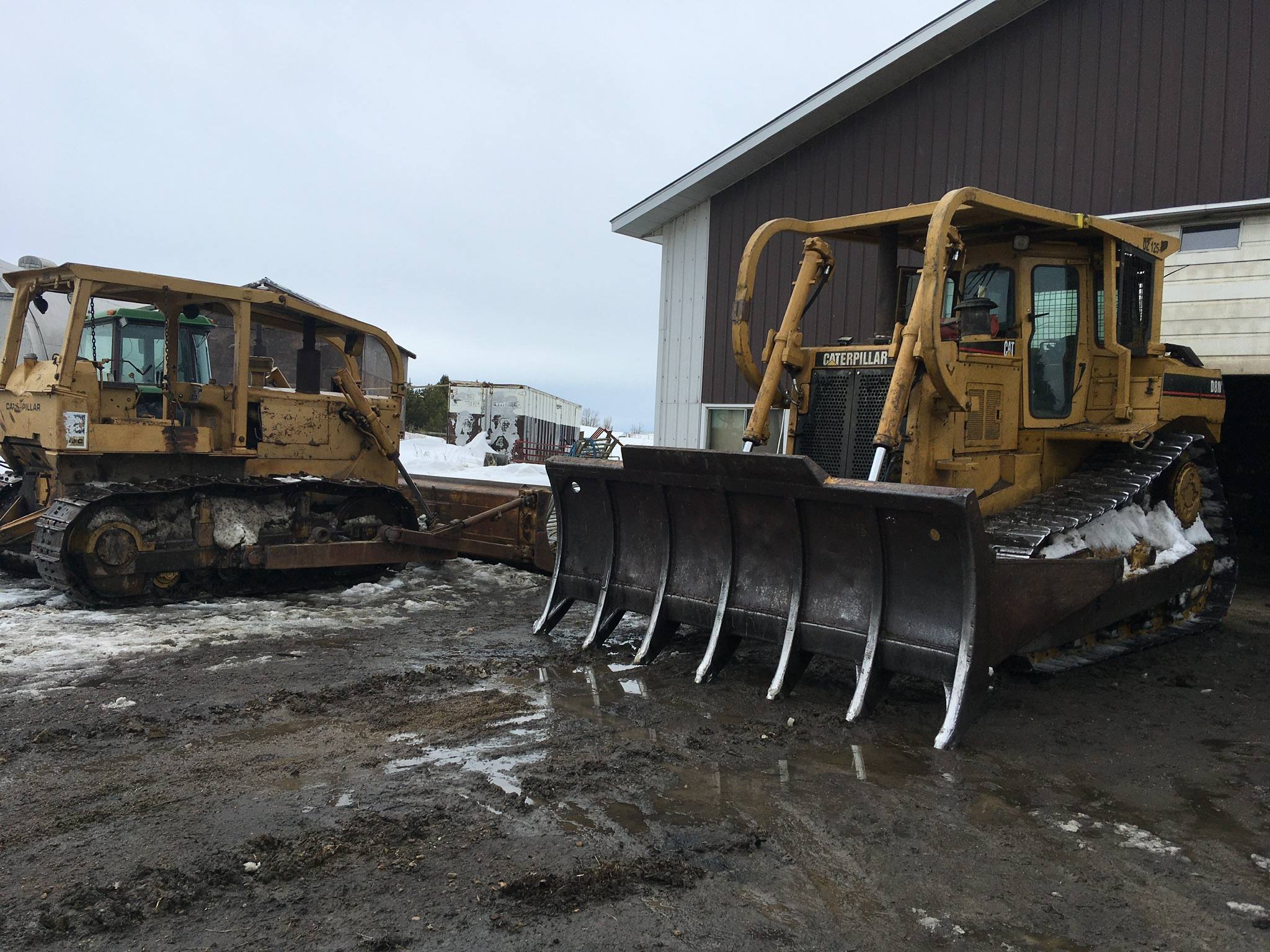

    Is that a d6 cat in your pictures saskfarmer, and is it yours or are you upgrading. We are looking for a 6 and need to know more about the good and the bad of the different series.
    A 6 is the most handy dozer for a farm because they are light enough you don’t need a bunch of extra wheels under them when you haul them. Either an 8 or a 6. A 7 is heavy enough you need the wheels but not the power of an 8. Dad had an 8 we used to clear a couple quarters of bush. She burnt and we ended up with a newer 6C powershift. They run a 3306 engine which is by far the cheapest to rebuild. Aside from it being a lighter machine it is by far more nimble and a decent dirt moving machine provided you keep your cutting edges maintained. I’m sure the newer high drives are even faster. My realm of knowledge is 1980 and older so maybe I’m no help.

      No we are keeping our old one looking for a newer one.
        • 4552
        Those are wide tracks like ours. Was that a seismic machine? Lots of those wide track outfits were used for clearing lines.

          A d7g has the same engine and powershift as a d6c/d, double capacity and often not much more. My d6h would out do a 7g, way better torque converter.

            I went with an 8. Because no one wants them, for the reasons you posted, so they are cheaper than a 6. I rarely have to move it, and only a few miles when we do.
            Not a good muskeg cat( understatement), and not very efficient for finishing ( that is why we have a 6 way on a tractor), but for moving bulk dirt, it's a monster, and I don't think anything smaller could knock down the size of trees we have, when even the D8 needs multiple attempts at some of these massive trees.
            Prior to this, almost all I had ran were differential steer 6 way cats, so this one was a learning curve.

              I have found a good d6d but my son is hesitant to buy something that is 10 to 15 years older than he is. I like the simplicity of the older stuff. It is not a 6 way tho. We only have small willow sloughs to clean up and a bunch of dirt work. Also thinking, smaller cat, smaller repair bills.

                Shopping for yellow iron is always fun. I’m with AF5 in going with bigger is better. It was my mom actually pushing for us to get our 8 after seeing how hard it was to knock the trees down with the old 6. Glad she did.

                  My policy with older equipment, is that one repair bill could easily be worth more than the machine. Therefore the purchase price has to be low enough that one could afford to write it off when the first catastrophic failure occurs. With a newer machine, you have no choice but to throw good money after bad.
