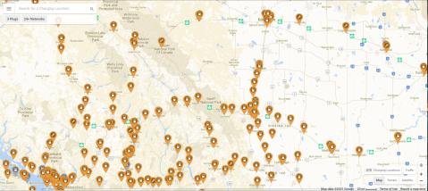

                  A 100 KW battery would take a little over 66 hours to charge with a 1.5 KW generator.
                  That's right, 1.5KW charging is mostly useless but you could use it for daily driving in the city. In the winter it actually is useless. All the orange dots are DC fast chargers so I can't really think of a scenario where you'd have to charge that slowly.
Name:	Screen Shot 2021-10-18 at 7.18.05 PM.jpg
