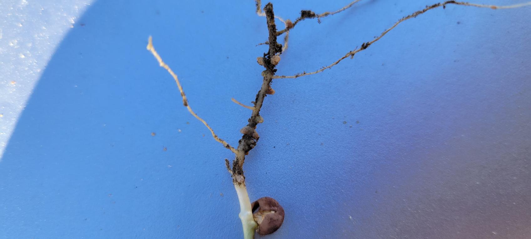

          This is what I found on the volunteer lentils.
            • 17045

              [ATTACH]8850[/ATTACH]
              We seen the same thing in our faba beans , the nodules kept going
                #57
                Nodulated nicely, probably fixed some N in the process, but with the weeds coming in there now, we are terminating them today.
