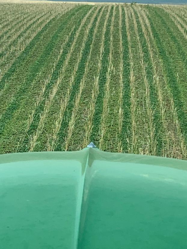

              • 17066
              This tells the story.
              Hailed out volunteer mustard.
                • 17066
                It actually tells alot of stories.
                1. There was no moisture to move the nitrogen out of the mid row in 2021.
                2. The mustard he grew this year has excellent germination after being hailed out.
                3. He may have an issue with volunteer mustard in 2022. While not a recommended strategy - mustard on mustard?
                4. We need moisture .
