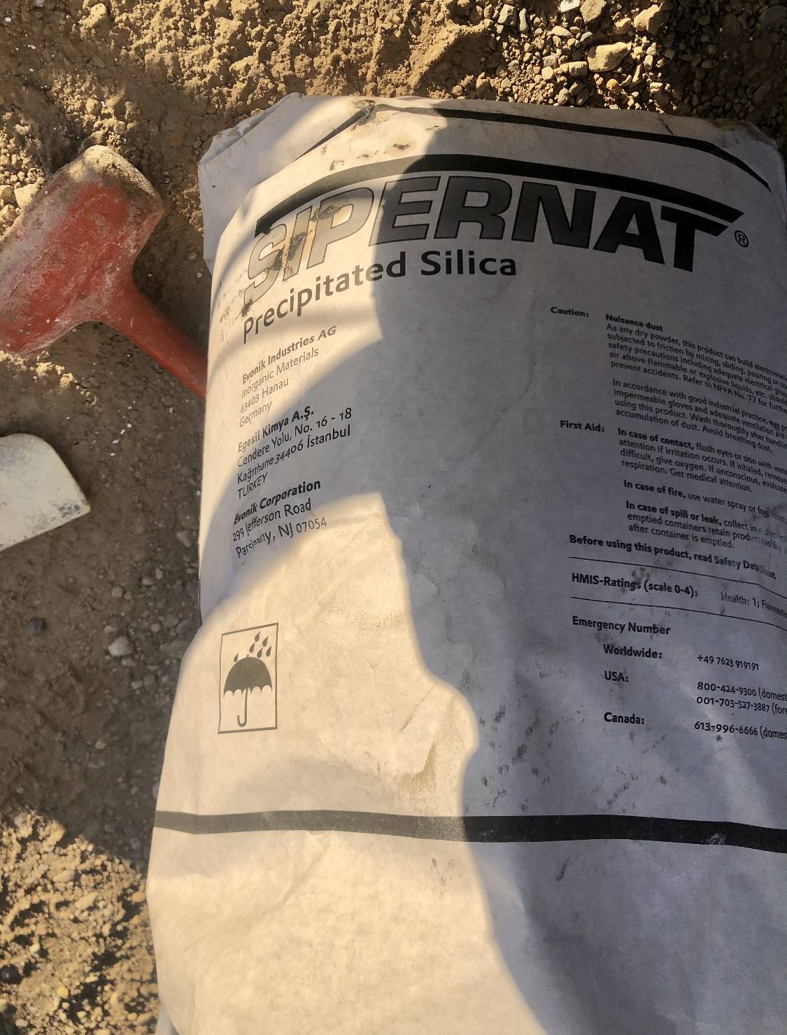

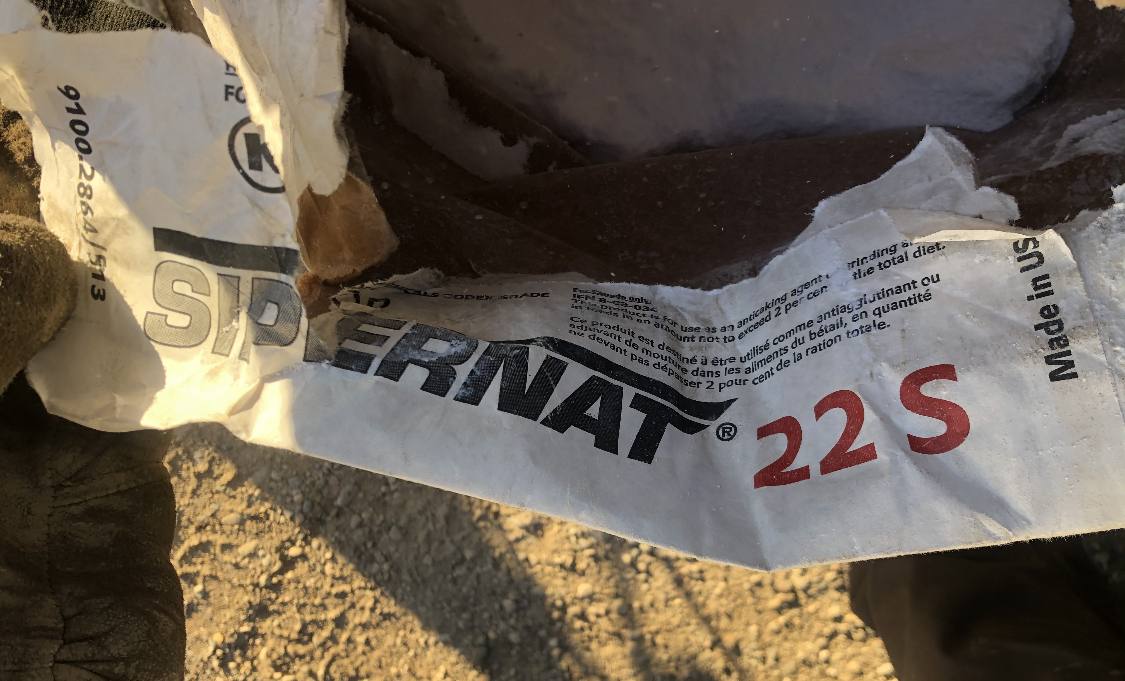

      If you add this silica powder into the auger as you are transferring the fert it will help prevent caking and help with flowing later.
      SIPERNAT® 22 S is silica with a high absorption capacity used as a flow and anticaking agent in many applications as well as a special-purpose ingredient for mechanical graphics papers. In plant protection, this product is recommended as a carrier in solid formulations.

                Taiga,
                Where do you buy the anticaking silica and approx how much a bag? Does it load the auger down when you add it like diatomaceous earth does?

                    Taiga,
                    Blair’s Ag for sure has it. Can’t recall the price but not extreme. Only need a cupful (like a coffee cup scoop) every few minutes as you are unloading into your swing auger to fill your bin. It sloshes around and mixes in the auger (same as if you are inoculating alfalfa for example). Big bag goes a long ways.
