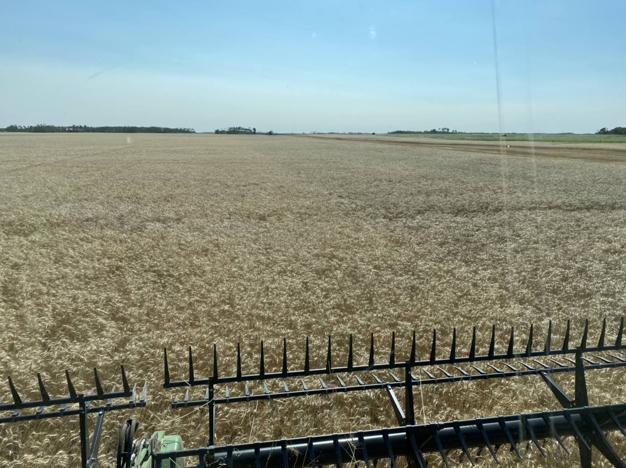

                Doing fungicide test plots 40 ft x mile long strips each company has two they are 120 ft wide x 1 mile but we’re cutting 40 ft.
                You can see a line on untreated strips go figure but will it be a yield difference.
                All gps done and scale
