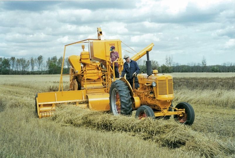

      Or you could prevent it this way -
Name:	Old Tractor.jpg
