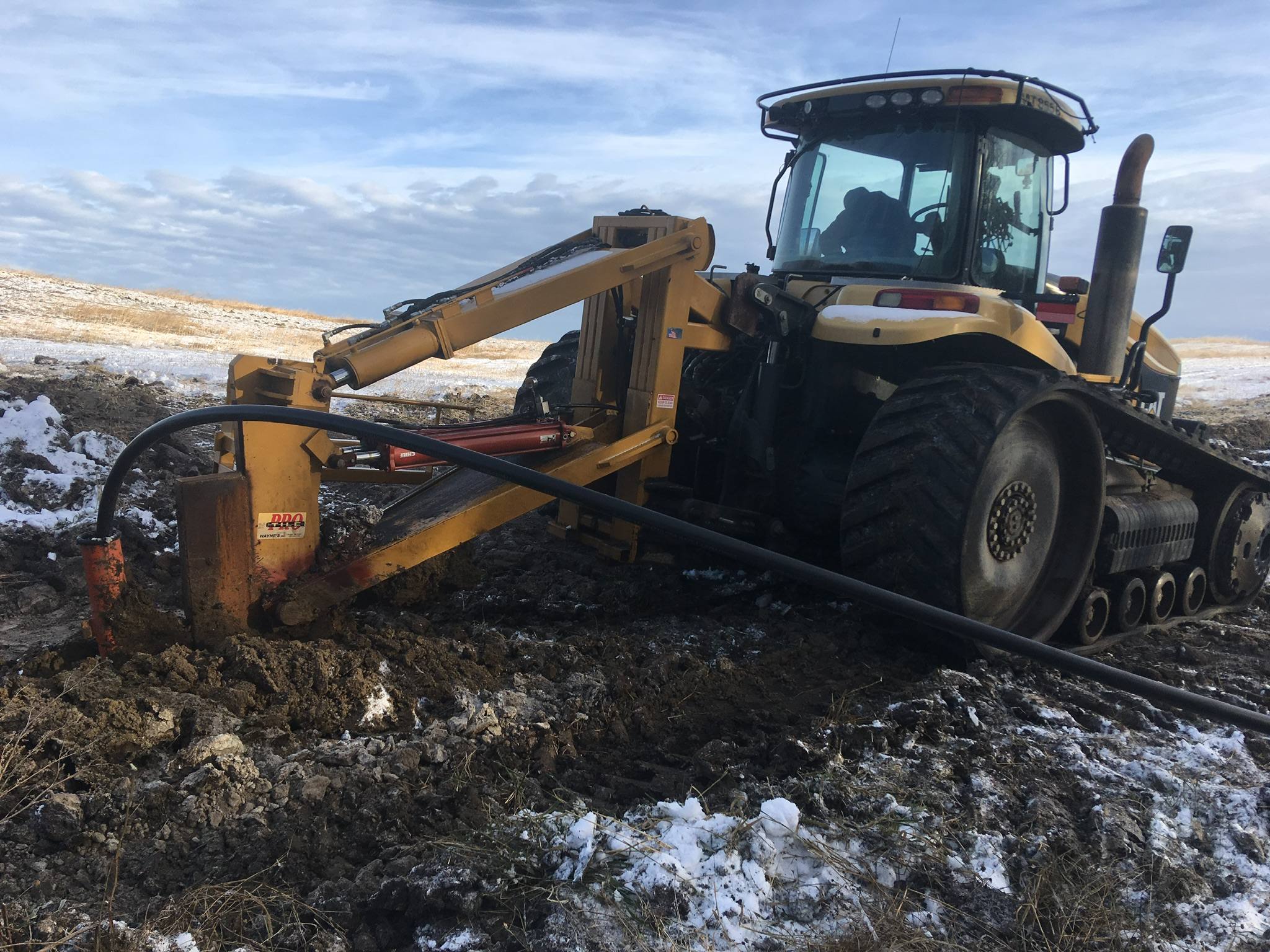

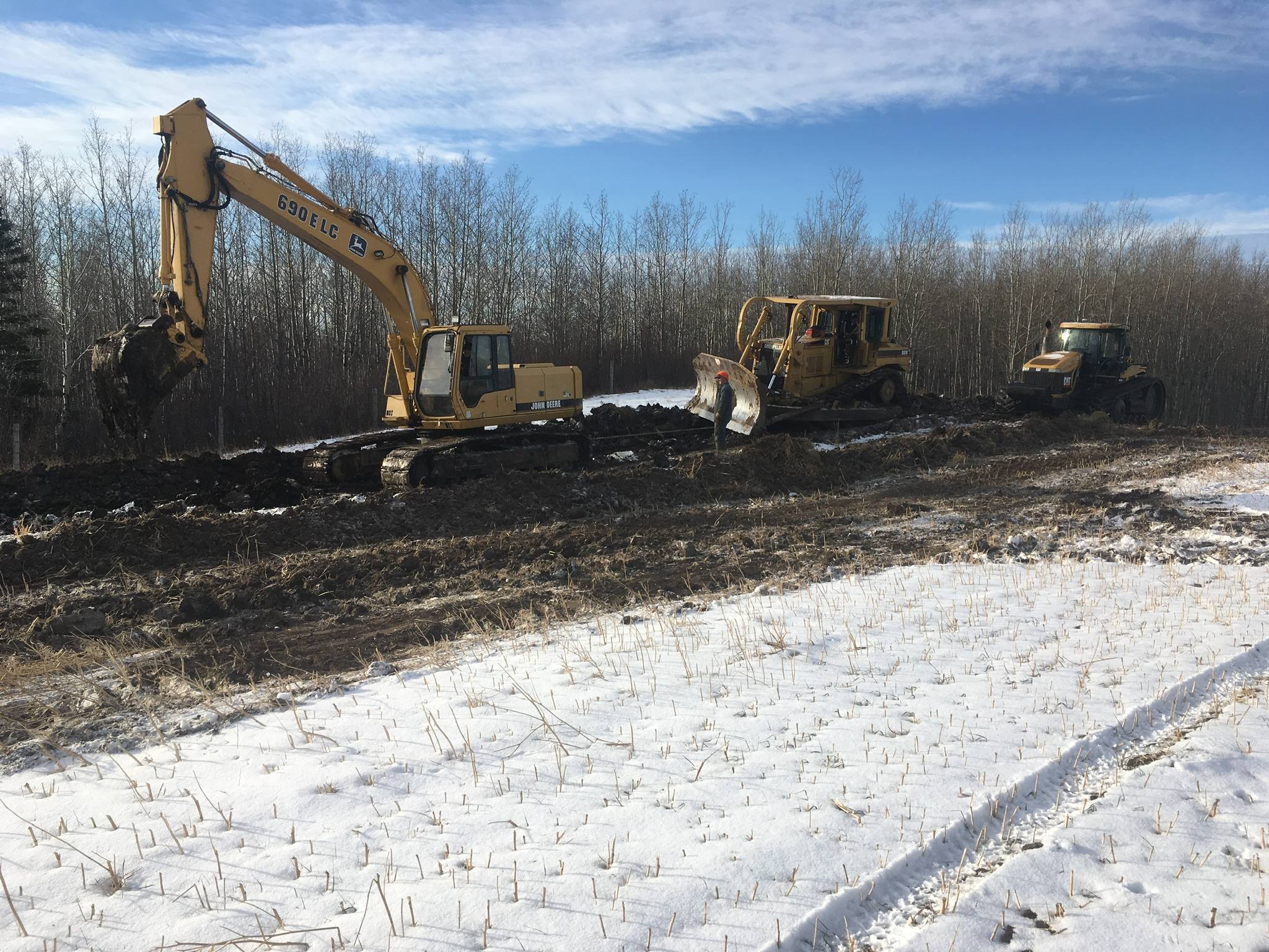

                  For every 2 feet of rise you lose roughly 1psi of pressure.
                  We have some summer lines that are 30” deep that we put in with a little plow borrowed from PFRA years ago. Lately we use a tile plow we bought and pre dig the trench ahead of it to get it around 6 foot deep for winter waterers.
                  Our clay and rocks make it more than fun to pull though it lots of times.
                  This was 2” line with lots of mud in November a couple years ago.
                  The $1.08/ft was just the pipe price. We have gotten mile long spools other years and the prices are much better. Make sure you’re looking for HDPE instead of the regular black plastic water line if you go this way. The cost is way less and it’s rated for higher pressure.
