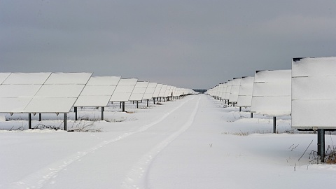

        "World’s ‘solar and wind capital’ freezing due to snow ‘blanketing millions’ of solar panels"
        https://www.skynews.com.au/details/_6232075665001 https://www.skynews.com.au/details/_6232075665001
Name:	snow on solar.jpg

                    They were installed at a 25 degree position. To my thinking,(and what do I know?) it seems too low. 34-39 degrees would increase the season length with some shading likely at lower winter solar angle. But if they're full of snow what good is it?
                    It was forecast to put out 24,000 MWH/yr. Coming in around 21,250

                      The snow and ice should melt off once temperatures recover. I brush mine off regularly. If they are leaving snow and ice on all winter that will reduce production a lot.
                      The angle is too low for winter compared to mine. That will also reduce wintertime production. Some arrays can easily adjust the angle seasonally
