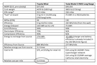

                    Yet these are being touted as a solution, to something, that part isn't quite clear.
                    As a proponent of EV's, where do you see hydrogen vehicles fitting in? Which is likely to improve to the point of being practical for long haul trucking, battery density/cost, or hydrogen efficiency?
                    I don't see hydrogen fitting in anywhere. If you're going to use natural gas to make hydrogen it's a complete blunder. Make the vehicles run directly off natural gas. This chart will tell you everything you need to know regarding hydrogen efficiency.
                    More expensive. Slower. More maintenance. Limited hydrogen infrastructure (You think Starbucks wants a hydrogen station in its parking lot?). The one point everyone loves to say is that hydrogen is quick to refuel. Yes in theory, but if you have to drive 15minutes to a hydrogen station and fill up, why not just put a plug in your garage and charge in your sleep?
