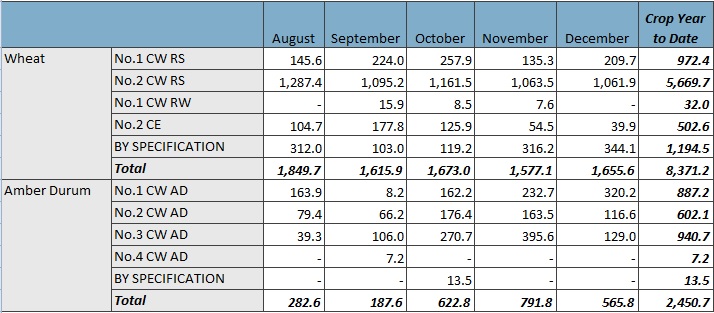

            #55
            Originally posted by CptnObvious View Post
            No grain is exported by spec alone. ALL grain is sold by grade and most of that has additional specs attached. Recent conversations with traders indicate Canadian grade parameters are still important to buyers.
            K thanks. I guess that's why on the monthly report they differentiate between wheat sold by grade and wheat sold buy specification
            If most of the grain sold has additional specs attached why is that not shown in the report? Only a portion is designated as by specification. Thanks for your reply.
              • 3959

                  #58
                  [ATTACH]7459[/ATTACH]
                  I'd only be guessing at an answer, I don't know the rules of whomever made this chart. where is it from?

                    #59
                    Sales seem to always have specification. 2 CWRS 13.8 protein, under 14.5 moisture, ergot under .010, FN of 300, etc. Some have more, some have less. I don’t know that those would count as by specification or not. Or which ones might. FN maybe as that’s not a grading factor.
                    Never seen anyone with a sale as “By specification” so they’d have to specify what that’s including a bit more.

                      #60
                      Umm Cap'n that's a chart in the CGC monthly Exports of Canadian Grain and Wheat Flour report.
                      You can download a copy here
                      https://www.grainscanada.gc.ca/en/grain-research/statistics/exports-grain-wheat-flour/ https://www.grainscanada.gc.ca/en/grain-research/statistics/exports-grain-wheat-flour/
