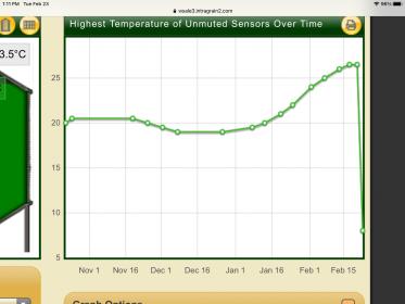

    Funny you should mention that, I have a bin that temperature of 1 sensor has moved from 20C to 25C in the last 2 weeks, that will be Saturday’s job pulling a load or two out.
        What was the sensor below that one showing. If it was 25 now showing colder the heat is just moving up in the bin. I wouldn’t leave any canola over single digits for temp in a bin
        • Sodbuster
          • 1161
          The sensor above it was 6C and the one below was 8C, we moved one load out on Saturday and now all sensors are close to 0. This is one of the few bins with no air. We try to fill these bin when the grain is dry and cool. No really spike in temperature but was still gradually going up.
