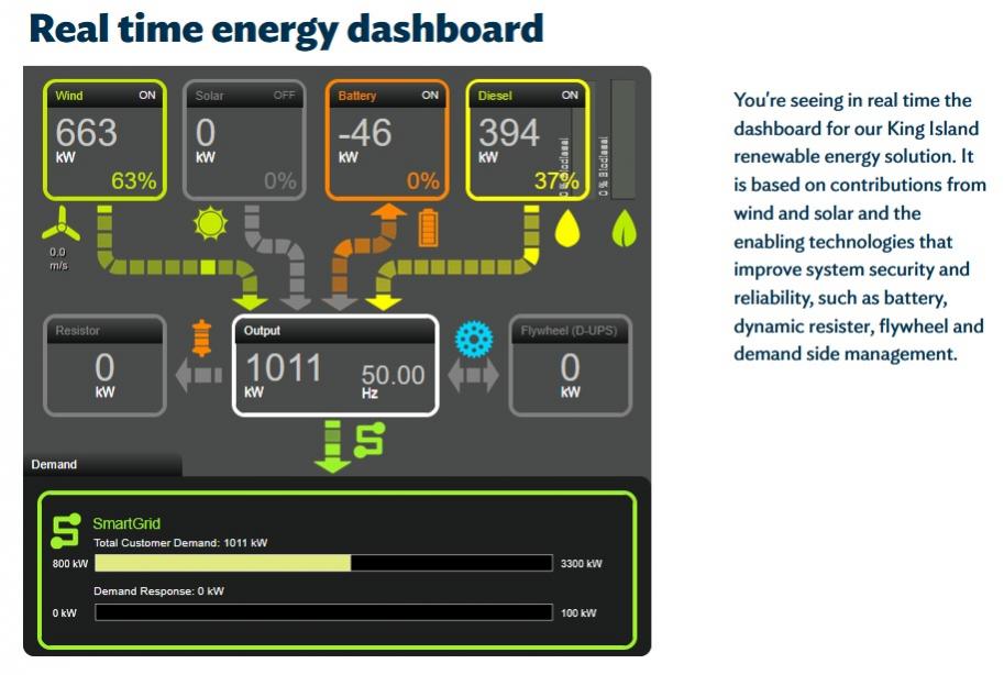

                      King Island, Tasmania
                      Off topic and totally distracting to watch..
                      Looks like their anemometer is busted and they're out of biodiesel
                      https://www.hydro.com.au/clean-energy/hybrid-energy-solutions/success-stories/king-island https://www.hydro.com.au/clean-energy/hybrid-energy-solutions/success-stories/king-island
Name:	King island.jpg
