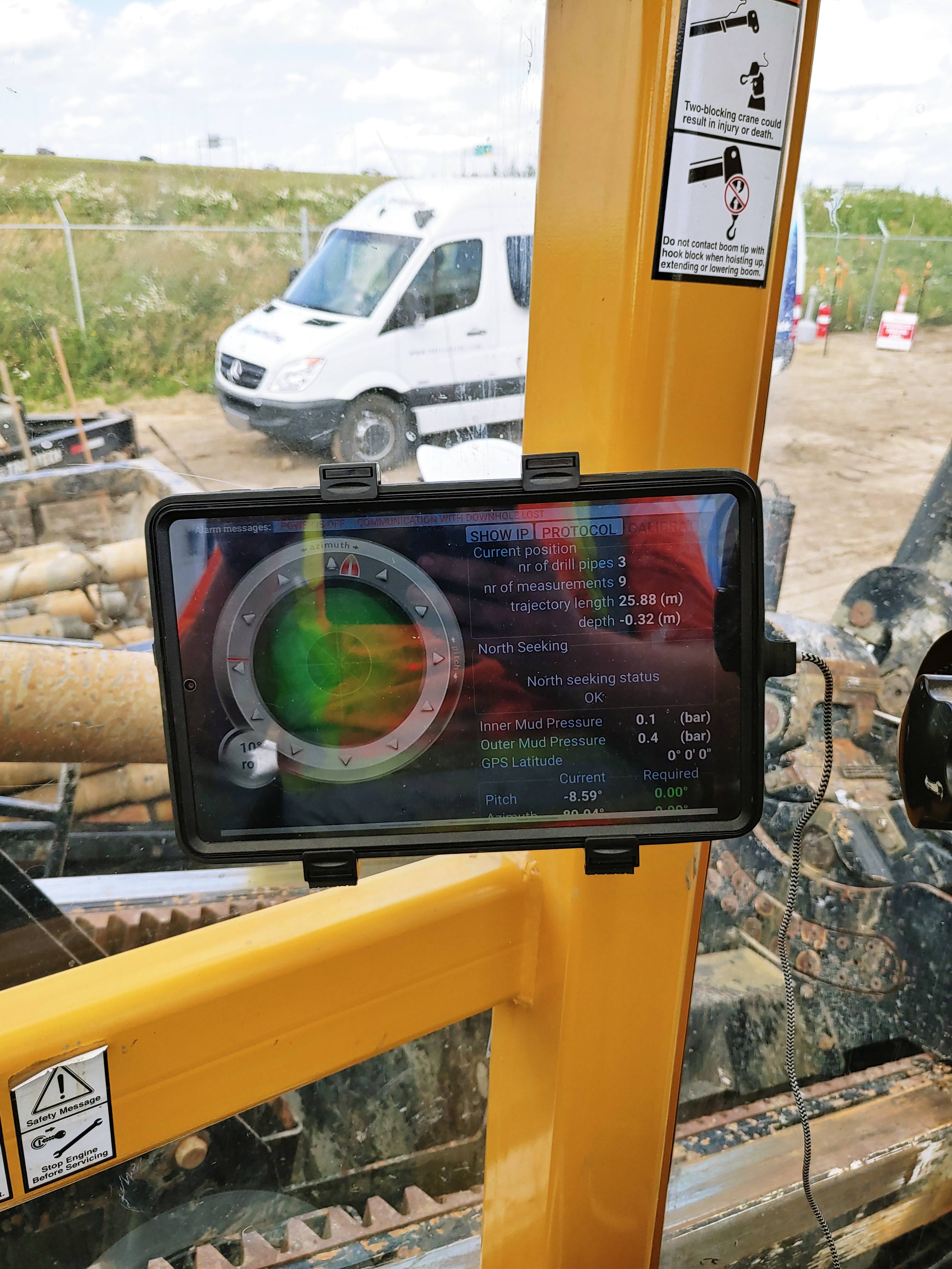

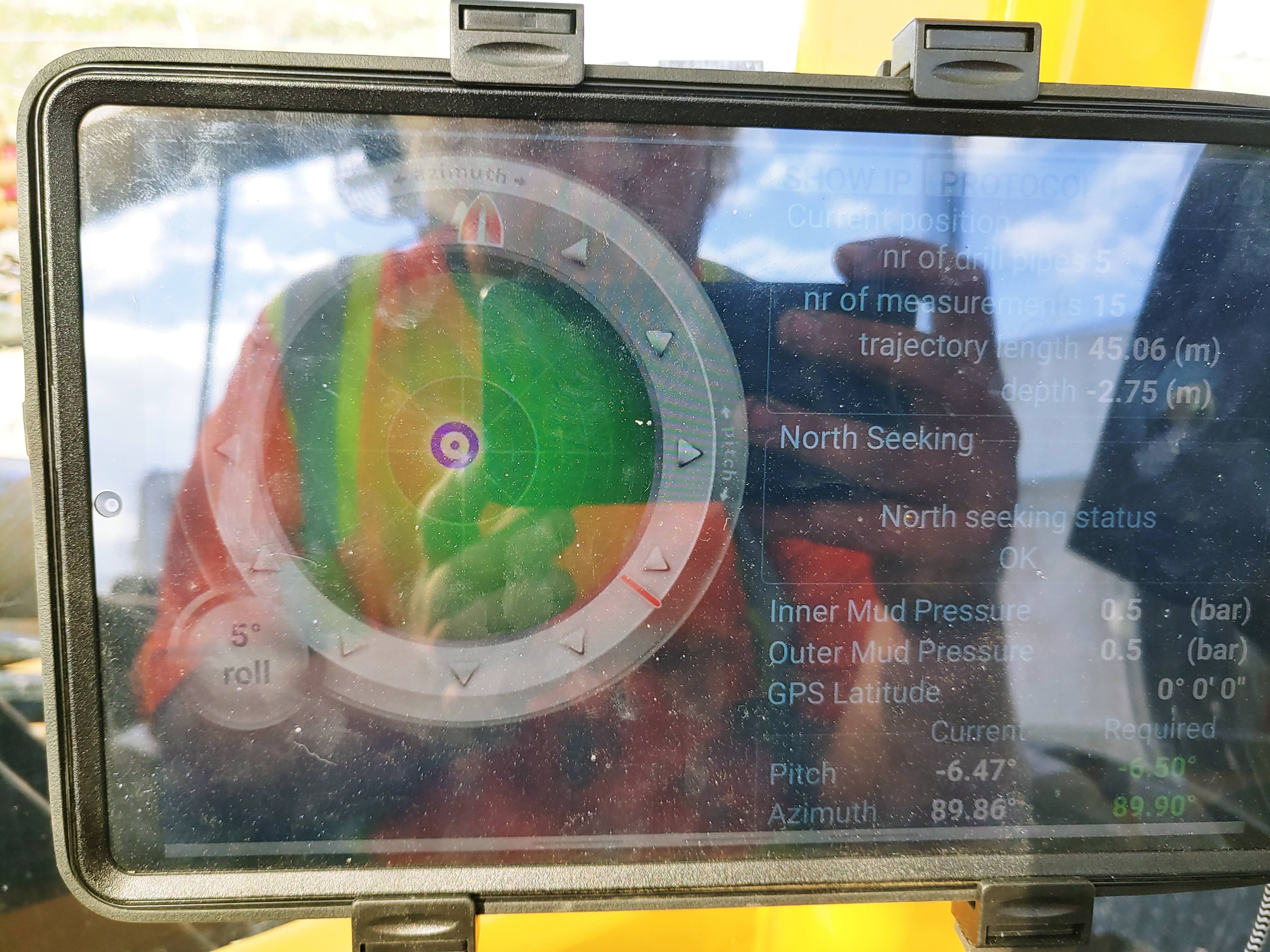

        We have different ways of steering... Walkover with an F5 falcon and manually calculating the pitch to maintain depth is common in smaller stuff. On big things we have access to high precision gyros.
        The Brownline system (pics below)is accurate to +/- 0.01 degrees pitch (up/down) and 0.03 degrees Azymuth (right/left) and updates in real time.
        The atomic gyro in this steering tool is so precise, the US military keeps track of them.
        There's something about walking 600m away from the drill, putting a red paint dot on the ground, then punching through the ground with the drill head on that exact dot.
