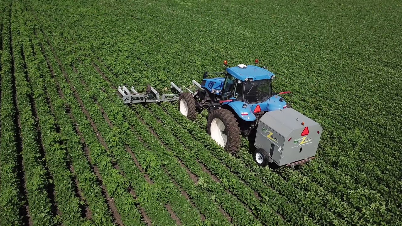

      There is another scheme: https://www.youtube.com/watch?v=-1CX2adzhoM https://www.youtube.com/watch?v=-1CX2adzhoM
