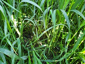

            Alfalfa under seeded this spring. Doesn't look like much now.

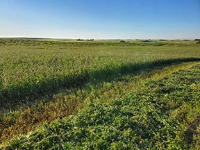

Name:	Baler oats field.jpg
            Overall field perspective.

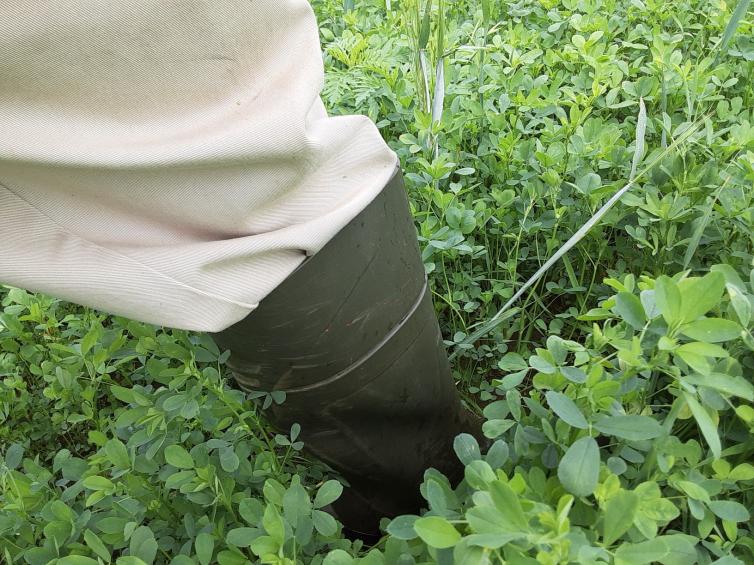

Name:	Alfalfa cutting.jpg
            Different field. Second year of cutting. Frost hurt it in first week of May a bit.
            Same management - 2/3 seeding rate and Buctril M application. Buctril M won't kill it, may set it back a bit under certain conditions.
            Took off around 4,000 lbs last year on first full cut. Last year only had 3.5 inches of rain - nothing significant prior to June 19. 1 inch came in 1/10 and 2/10 increments. We didn't see significant rain until June 9 this year - around 4 inches to date.
            This is Sask. Crop Insurance J and K land.
