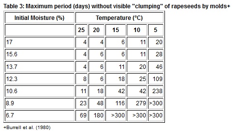

            Higher oil content or specialty oil canola seems to heat up faster.
            Under 9% and 10 degrees for storage is what I am comfortable with. Anything that tests very dry and heats is usually respiring yet or binned warm.
            Straight cut canola is much more likely to be respiring in my opinion and must be cooled as quickly as possible and watched like a hawk for 6 weeks or so. The cooler the better. Tough/damp straight cut canola has a very short safe storage period.
            Probably cut these numbers in half for straight cut.
Name:	Moisture Temp Canola chart.jpg
            Have also found that the same canola stored in a hopper bin can heat faster than flat storage if there is a warm fall.
