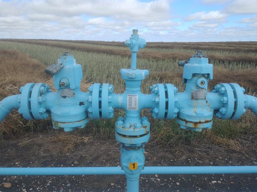

        Blackpowder, I dont know yet on the high capacity line. When I inquired several years ago it was 30+K for a small service line to run about a mile and a half. At least I think they knew our yard was on the east side of the quarter and the line was coming from the west....not that they were assuming it was only a mile away from where they needed to tie in.
        There is a NatGas station north of the community I live near. There is a high pressure line running south from that station that branches out to feed two other towns. On a piece of our land there is a riser with shut-off valves to each of those communities. I am asking if they can tap into that assembly with a regulator and a line to my farm. It would be a little closer than coming from my neighbors who are only supplied with a one inch service line. My idea is to have an adequate supply and not stifle any future growth requirements. But I bet it would cost a pile of money.
        I bought the land with the existsing riser valves on it and receive nothing for the inconvenience of it being there.
        Maybe on a winter cold snap I need to cut the locks and turn off the taps to the other towns until SaskEnergy sees things my way! Where do you think that will get me besides jail or the mental health floor/wing of the hospital?
          I would sacrifice some land if they wanted to upgrade this riser site and supply me with a reasonable cost service using a regulator.

            [ATTACH]5093[/ATTACH]
            And so close to that damp canola...

                caseih, so close to the crop land that when we got the 60 foot Bourgault I snagged the protective pigpen around it. Lol, called right away to report it. They mounted flags on fiberglass rods onto two corners...hoping to improve visibility, I wasn't flying a bloody plane over It!

                    [QUOTE=farmaholic;427011]caseih, so close to the crop land that when we got the 60 foot Bourgault I snagged the protective pigpen around it. Lol, called right away to report it. They mounted flags on fiberglass rods onto two corners...hoping to improve visibility, I wasn't flying a bloody plane over It!
                    You hitit? Geez!
