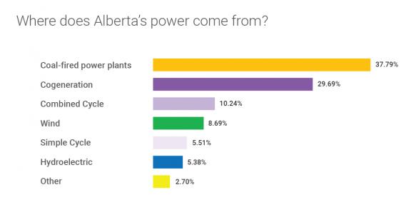

              We are all in agreement that intermittent renewables can't supply base load without storage. No need to keep bringing that up.
              Take a look at where Alberta's electricity comes from. Then read the AESO assessment for Renewable Integration.
              https://www.aeso.ca/assets/Uploads/2018-Transmission-Capability-Assessment-for-Renewables-Integration-Final.pdf
              https://www.aeso.ca/assets/Uploads/Addendum-to-2018-Transmission-Capability-Assessment-Final-Feb2019.pdf
