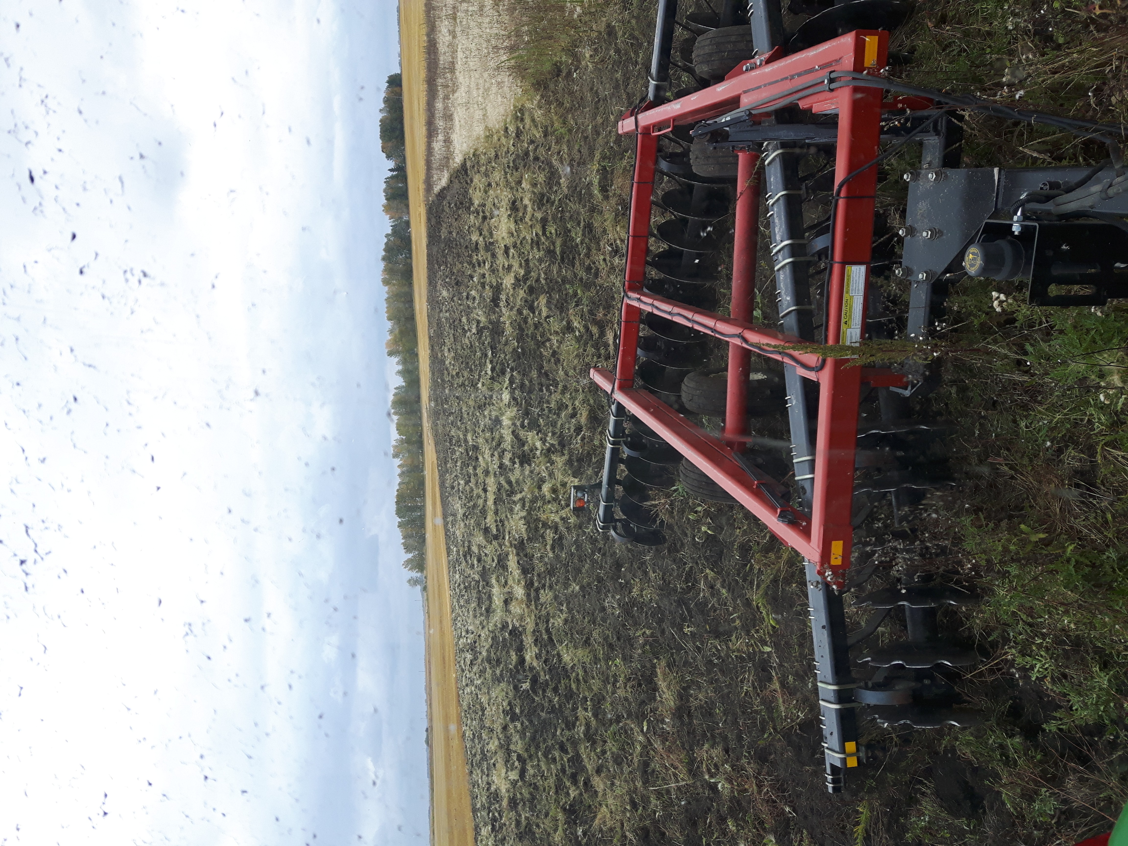

      Ours is a 18ft.

            I have a 22’ Wishek 842NT for sale with 29.25” blades (new is 30”) front and rear in the Peace. I just want to get a bigger one now (bought a larger tractor earlier this year). Has only ever been used on heavy sod.
