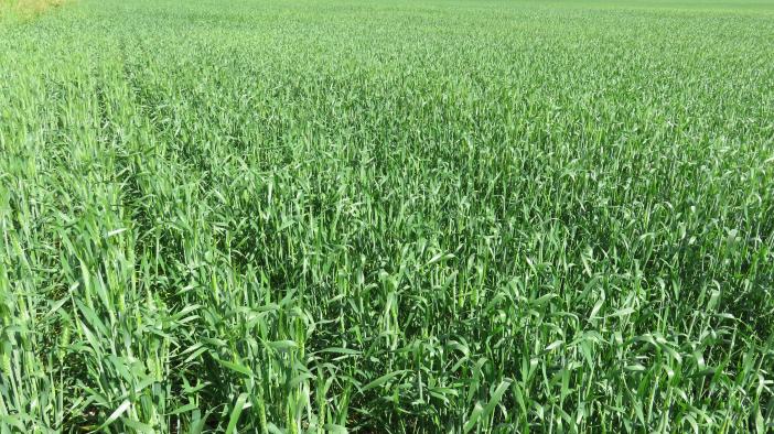

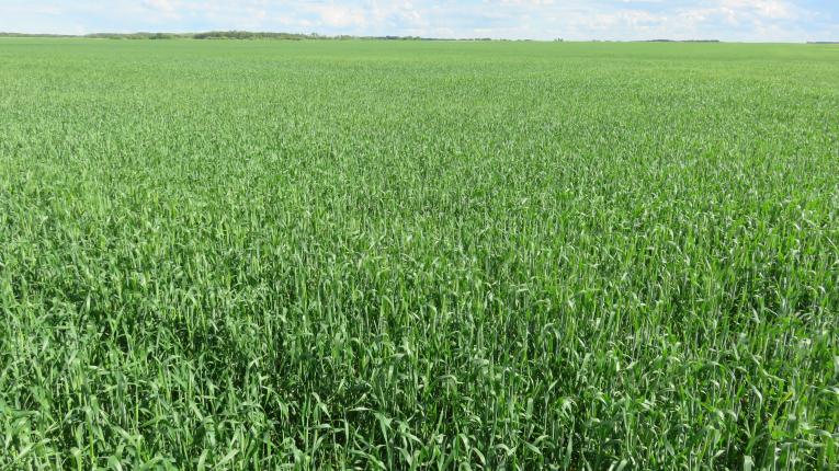

          The Landmark, first pic has much less leaf area, 6" shorter so far. Second pic is Jatharia. Maybe getting short on moisture?
Name:	wheat by yard.jpg
ID:	766519Click image for larger version
