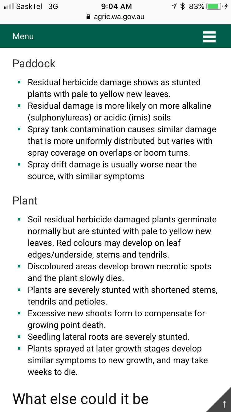

    Pretty much all of the broad leaf chemicals you spray on cereals will leave the tank and the booms with the same residue. The merge in the odyssey, viper, and liberty type chemicals will lift the residue off and out the booms it goes. We even buy the merge seperate and mix it with rince water and leave it a couple days in the tank and booms to help clean it out.
    These companies dont want to even talk about sprayer residue because they know that some are impossible to clean out. Couple of lawsuits around here the last couple of years and they settled with non disclosure agreements so others would not find out.

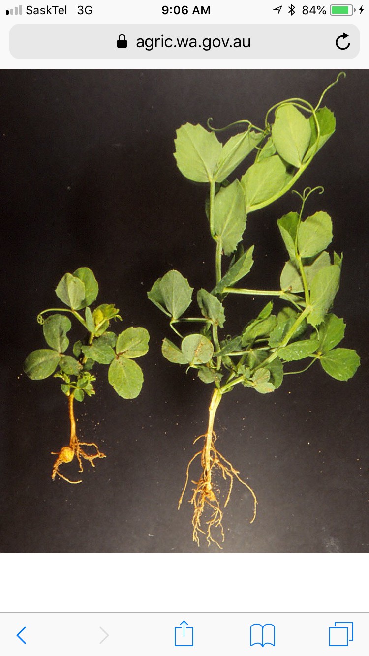

        Steller, axial, prepass, are florasulam based chemicals they are some of the worst to blame, Basically its group B chemical damage. You can get your damaged peas residue tested. When our field had resudue damage we tested and it had florasulam damage. The roots turn brown and the tops are yellow and stunted.

          I want to make something clear, this is not a debate, it's a discussion on my part. I am NOT balking anyone's responses, it's all good food for thought.
          So how do I explain all the irregular patches in the field? Why wouldn't herbicide damage be more of a blanket of symptoms than a patchwork of symptoms?

            If it was residue in the soil it could break down faster in some areas and others. It would be pretty tough to tell the difference between chemical damage and disease unless you were to Tissue test.
