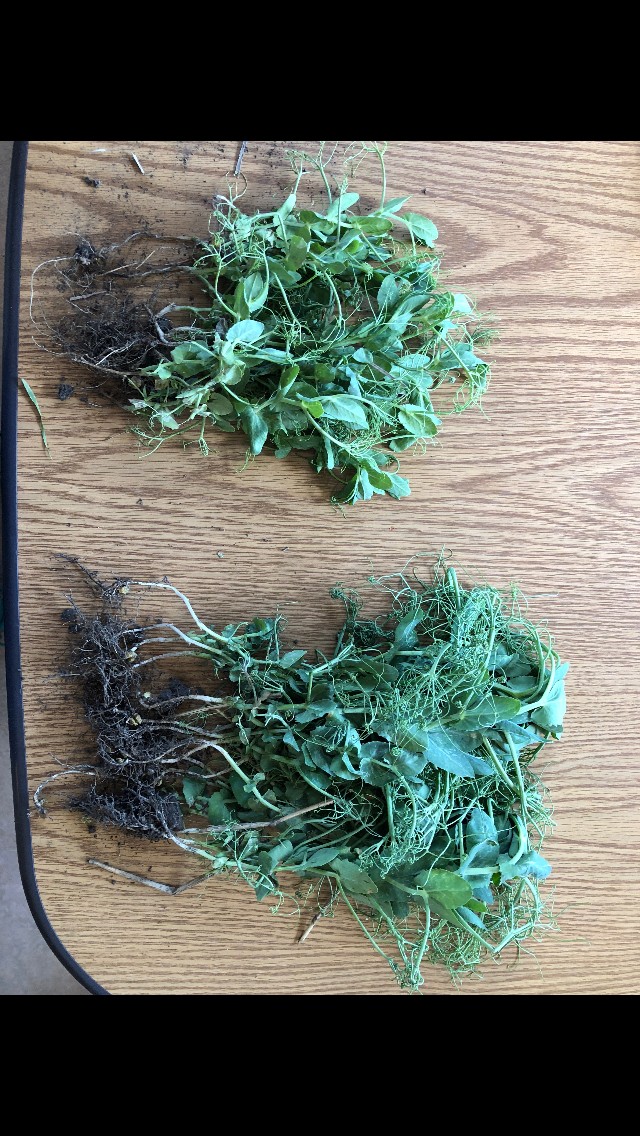

              I have had trouble here for years with peas looking great and then getting brown stems. Some times I alos have yellow herbicide injury and the plants die, but usually it just brown stems that weaken the plant and reduce yield. Often the plants are bent over on the stems at harvest and regrown upright. Would have been 6" taller if the week brown stem would not fold down.
              Been doing a little trial this year and wonder if this is what is going on. First of all the soil is loaded with disease and weak plants get hurt. It seems like malnurished plants get hit harder. I have soil and tissue tested for years and it has been very inconclusive. Used to grow very good peas and it was a no brainer. Now I struggle to grow them, but have noticed that new fields I farm grow fine and neighbors with a minimal fertility plan grow them fine. So this year (and last year) I have been digging up my pea plants and plants from neighbors. I am finding that my pea plants have either less nodules or smaller nodules. Noticed this last year, so did a trial this year and put full fertilizer down with my peas on 40 acres just like for wheat. Those peas look freaking amazing, while the peas with just phos and phos+S look stunted and not thrifty. Brown root rot showing up in soggy areas of the normal fertilizer and NONE in the full fertility package.
              Here is what I think is happening. Been using a lot more fertilizer now than I did years ago when peas were a no brainer to grow. Seems like my higher residual fertilizer from the previous crop is hurting nodulation, so my peas are not getting enough N from the nodules. Neighbors with good peas and lots of nodules are low Nitrogen users and have very little residual from the previous crop, just like I was when I grew good pea crops. Areas that I disked last fall or had blacker color seem to have released more N and the normal fertilized peas look good in those spots, just like the peas with the full fertilizer package.
              So in my 40 acre trial I used 120N. Not sure if I had put on 40N, would the nodules kick in later on and produce a good crop or would I just get a crop that looked like it only had 40 lbs of N. For those of you having trouble, I encourage you to try a few acres with a lot of fertilizer once to compare your root health.

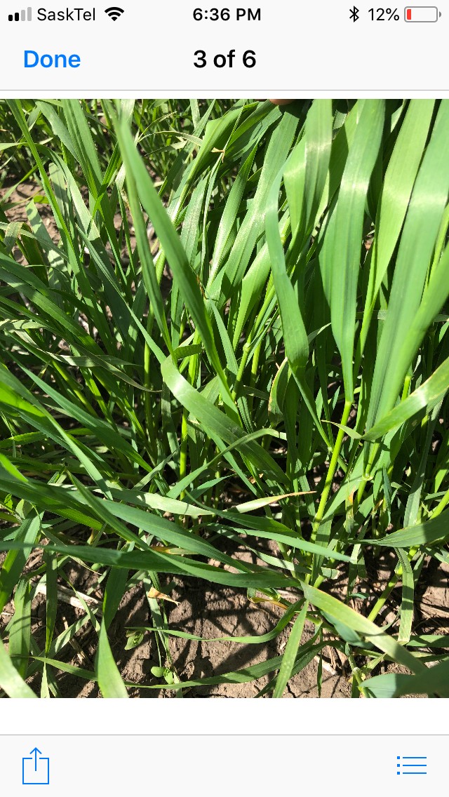

                What do you seed into that disease infected ground?..sarcasm a little bit not to offend.
                Here’s the wheat on that same field this year ..
                Looks ok so far 🤞

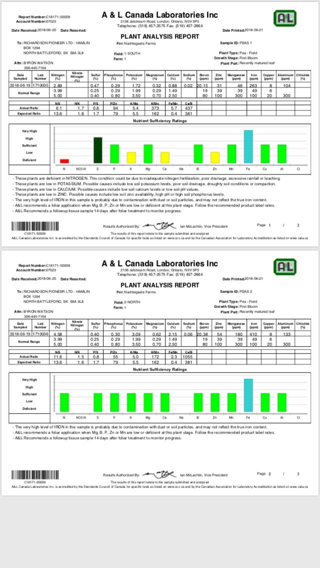

                    Doing a current soil test now to compare fields as well
