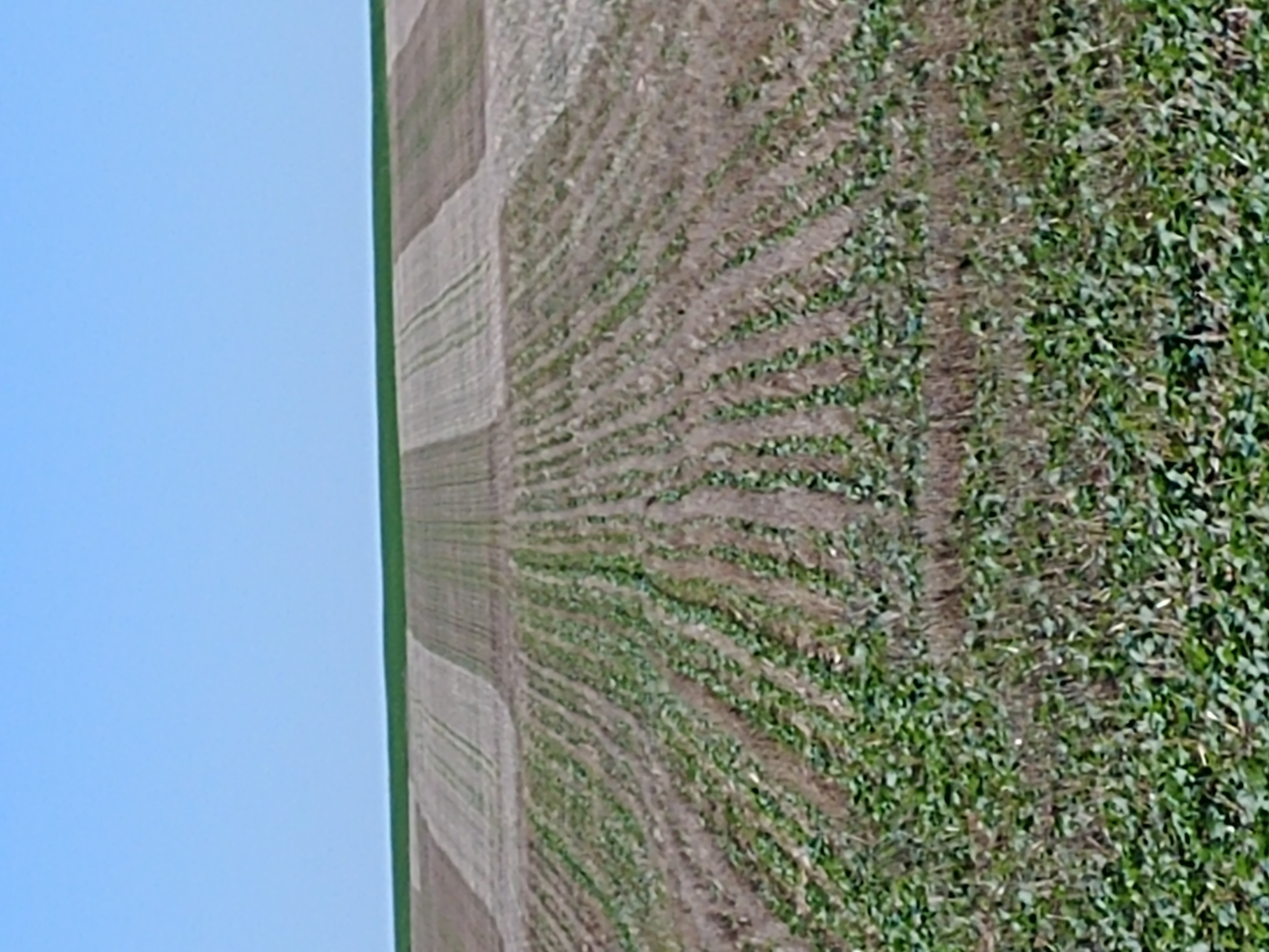

      Neighbor's canola seeded with a MF36 discer.
        • 3957
        #53
        He must have made a few modifications?
          • 17489
          #54
          Yup, GPS and a smart hitch and GPS controlling the pivoting wheels to keep the discer from dog trailing up steep hills and passing the tractor coming down the other side since its hard to keep straight because of shallow seeding. And slow speed seeding sprockets.
