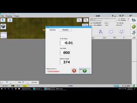

            Once you have RTK you can pretty much do anything. Have a look at....
            https://github.com/farmerbriantee/OpenGrade https://github.com/farmerbriantee/OpenGrade
            Cat guys like it, mount on the blade and you know exactly where you are. Or sc****r etc.
