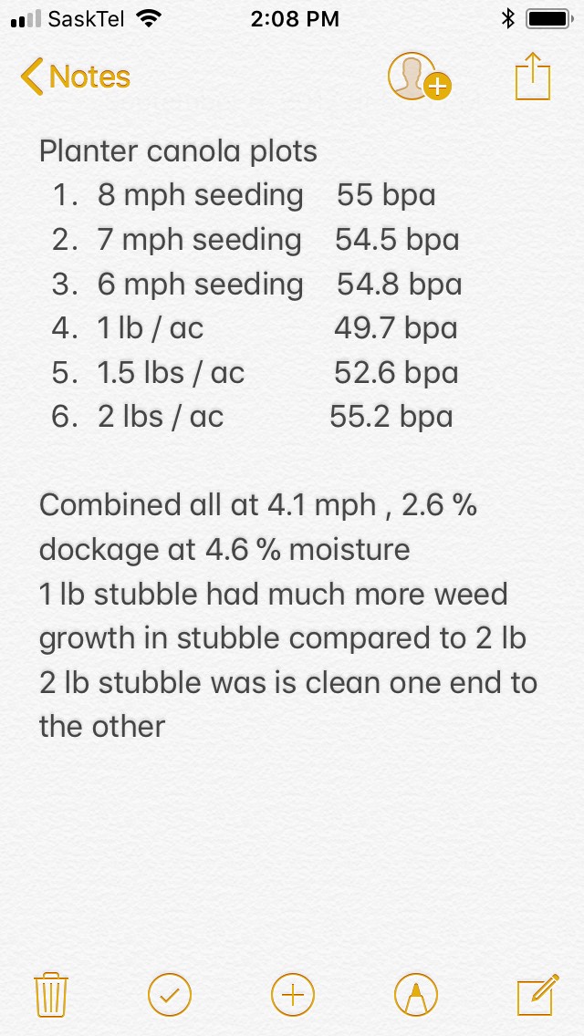

    These were our results from the planter trial ...
    We will do a seed rate trial again next spring with 1.5 , 2 , and 2.5 and maybe 3 And see if that yield bump continues . We have been told it flattens out at around 2.5 lbs / ac depending on seed size .
    Depending on the tractor we use, we will aim for 8 mph or better to get the most efficient use of the planter we can .
