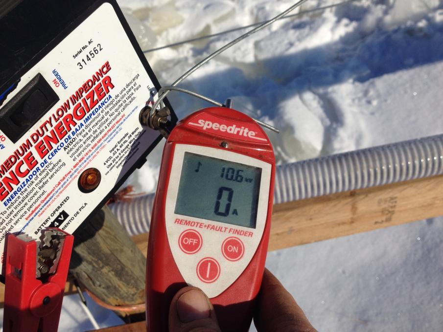

        Igot a 3" by 2" panel and putting out over 9000volts.
        This gem extracted from a previous post above.
        I call bull shit. Six square inches of panel and "9000volts" output NOT.
        " Igot a 3" by 2" panel and putting out over 9000volts."
        One mistake maybe...but this is truly not within any reasonable parameters.
        LOL, guess you don't know anything about electric fence energizers! It's a 1 watt solar panel charging a 4 volt battery. Can put out 10,000 volts at max power. Been around for years, cheap simple technology.

          #64
          I too am laughing out loud.
          Power is measured in watts. What you are talking about is (max) one whole watt; by your own admission.
          That's enough to light a 7 watt LED bulb for less than 10 minutes without recharging.
          Power is measured by multiplying volts times amperes. If you need 9000Volts output then the amps from a 0ne watt supply have to drop to one nine thousandth of an amp.
          I don't apologize for Ohm's law. It has stood the test of time and you tell me what else will run on 0.00011 of an amp and do much useful workl
          For sure that 2 inch by 3 inch solar panel itself isn't outputting 9000 volts continuously...nor intermittently There is additional circuitry providing the voltage amplification which in this case is apparently specialized for an electric fencing application.
          Such an application would feed pulses into an insulated fence. It's not as though there is actually even close to one watt of power available to anyone trying to connect anything to that fence at any point along maybe even miles of wire.
          That where inevitable losses have already come in. You know, infinite resistances not yet attained in insulators or any part of the electric fencer or that attached to it, voltage drops, heat losses and somewhat imperfect battery technology to name a very few. Even your fencing techniques.
          As an electric fence shocker it may be remarkable....as a power supply for anything else then I need recharging from some other source to continue laughing.

                  #68
                  Oh man, so much dumb! This is the kind of post that really opens my eyes to how little some know yet profess to be experts. Makes me realise how pointless the discussions are on green/alternate power sources when some of those arguing don't know the capabilities of simple technology that has been in use for 20 years on farms and ranches.
                  Here's a meter reading from that fencer yesterday - it's a short, temporary fence so I didn't bother putting insulators on as I knew we'd have more than adequate power.

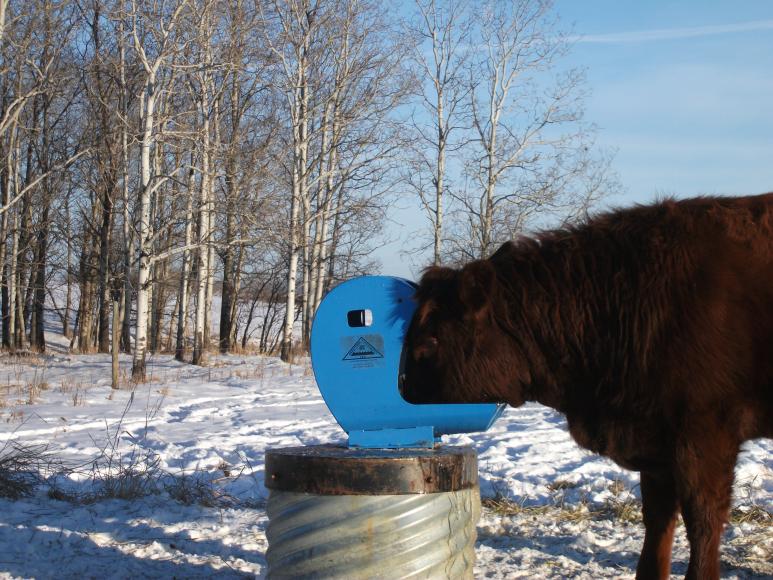

                  This is not one of our winter systems as it necessitates breaking ice off the trough every day. Will be done with it for the season in a couple of days. Then we move onto a smarter solution yet for watering - no electric or solar power and works without issues below -40C. Maybe think about this and come back in a couple of days and tell us all how it can't work?

                    #69
                    Hydrant watering bowl. Activated by cattle. Wish those were out when I had cattle.
