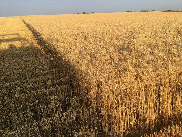

              Well we got to 40% yesterday as the wheat harvest continues.
              Some are talking canola is 5.5 moisture thats a money loser. Were hoping for a rain next week a big rain and then combine at 11 or ten. We have lost more canola over the years to harvesting in hot idiotic hot harvesting than wet.
              Some are going all night and sleeping in the day.
              Bags cool nice in a few days.
              So its real early hell its first week of September going into second.
              Its not Nov 26th like last year. Plus big iron starts tomorrow and like the Americans you need your hrs done and now you wait for soy and corn so you can attend the show.
