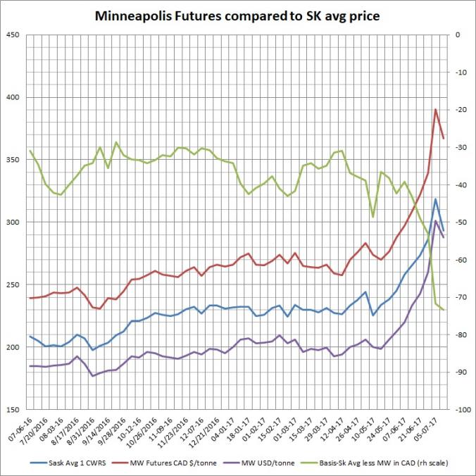

    Grain companies are adding more to their bottom line from Currency Exchange than elevation fees.
    At the close last night December MGE Wheat was $7.83 1/4, even with our improved dollar the value( $0.79.00us ) in CAD's would equal $9.79 CAD/bus.
    Easy to hide the exchange rate when it's hidden in the basis. I don't see elevation charges listed on my tickets anymore, everything is in the basis.
      • 3958
      Good to track basis and prices expressed in CAD
      July 12/17
Name:	Minneapolis futures compared to SK avg 1 13.5 CWRS jul 12 17.jpg

                    • 17066
                    Interesting that the graph shows basis as minus 70 cents but in Canada it's reported as a positive basis....hmmmmmm
                      • 3958
                      That is actually $-73.50 CAD basis SK average-MWU
                      Minot area elevators are around $-39.50 CAD/tonne
                      Portland bids for #1 13 were about 10.35 CAD or better today. #1 15 11.40 CAD or better. Local bids for #1 13 were 7.83 early today dropping to 7.58 at the close. Basis got even worse.
