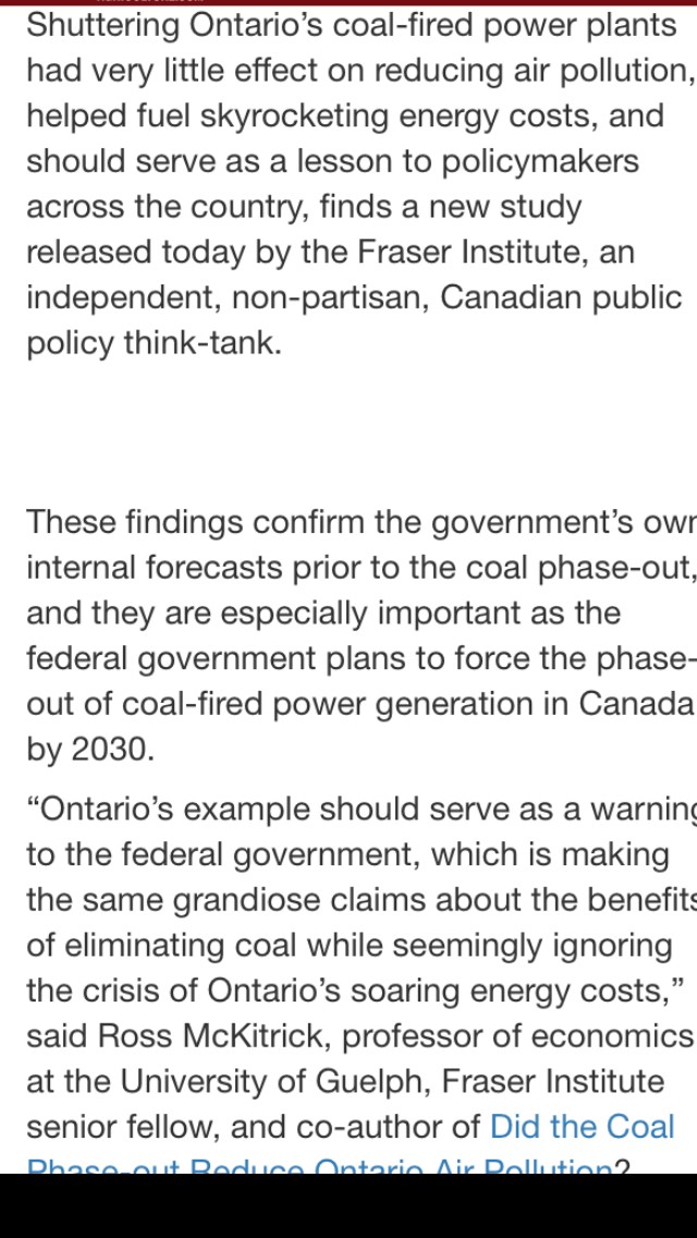

        Well if you can't find a measurable effect in Ontario from years ago shutting down all coal fired generation in that province; then should it be concluded that the further away realms in the world must have been the ones who were always most affected.
        Or is the truth that nowhere in the world did anybody else notice one iota of change just because Ontario took a certain move.
        This absurdity will become pretty evident when our federal government punishes Canadians; but overlooks making the US being held to the same standards. Our leaders aren't up to playing in today's real ballpark.
