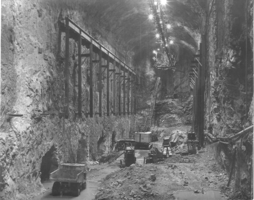

              Hydro Electric requires that you get water pressure working for you to spin the turbine
              Here is a diagram of a project in NZ I had the privilege of touring
              [URL="http://manapouri.flexedesign.com/station-info#&gid=1&pid=2"]http://manapouri.flexedesign.com/station-info#&gid=1&pid=2[/URL]
              If the goal is to make some serious power it gets complicated. Average annual output-4800GWH
              Water pressure at turbine 325 psi. I could be wrong
              A picture of the machine room construction, dug from solid rock 200 meters below lake level
