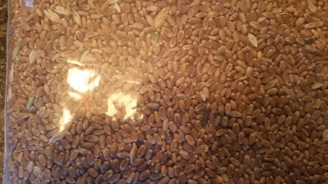

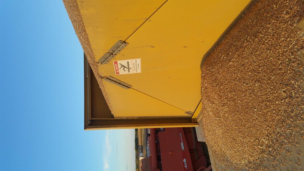

                  Claas is a 3 pass system. 11mm clearance 750 rpm on cylinder to thrash wheat. 0 whitecaps and 0 damage.
ID:	765093Click image for larger version
                    • 10017
                    I saw the APS, but what is the third, rotors threshing some? At 11mm the 9600 would leave kernels in heads. If no damage they have it figured out. Wonder why their cleaning area is so low loss?
                    9870 Rotor 700, concave 25, fan 800, chaffer unchanged, sieve 4, in canola. How is Claas?
                    Is the straw chopped spread fine like a rotary?
                    • foragefarmer
                      • 3553
                      Klaus
                      "0 whitecaps and 0 damage."
                      Looking at your attached sample, are those not "White Caps" in the top left hand corner of your sample?
