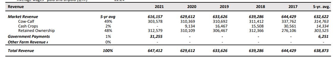

            Can anybody explain this to me?Click image for larger version

              Originally posted by The Don View Post
              Can anybody explain this to me?[ATTACH]12091[/ATTACH]
              Percentage of total revenue averaged over 5 years.
              Unless you're subtly referencing the inclusion of cash crops and government payments into the calculation for COP. Which I say is bullshit as well and would call them on it.
              But at the same time, I also know that they want to understand which operations are most profitable and why. In this case, it would be due to diversification of income sources.

                How it appears to me is.
                They are selling the calves to their backgrounding operation and claiming it as income for the cow - calf operation in that year. Then adding the sale amount of the backgrounded calves to that income.
                They only have one group of calves that are sold off the farm to produce income. It showed total revenue as $647,412 for selling 239 calves off the farm. Those are expensive calves!
                  Ok. I didn't look into the particular farm to see how many calves they actually produced. If that is the case, the only one they are fooling is themselves.
                  But maybe they got FCC convinced they are doing a bang-up job.
