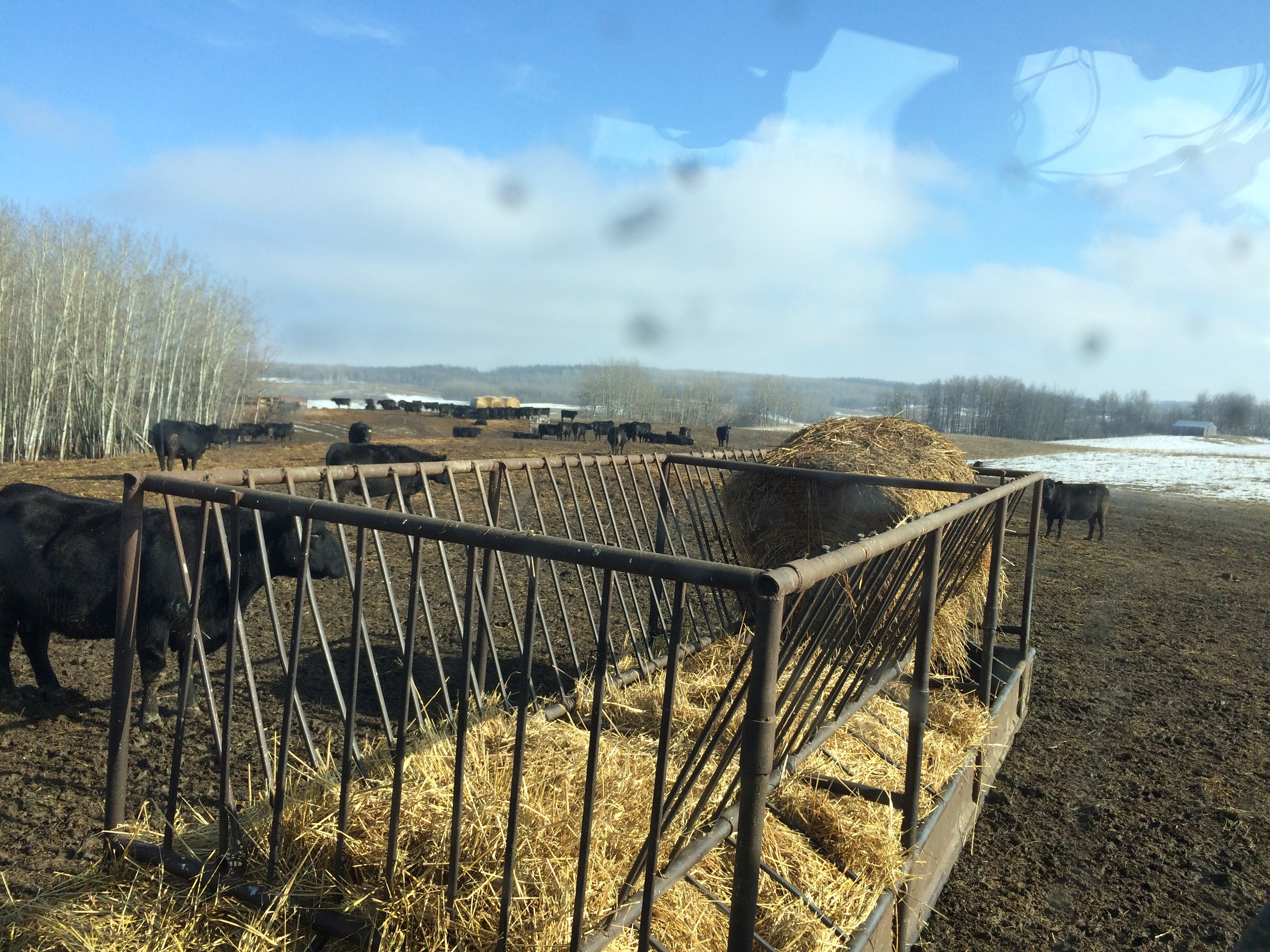

    Really? the waste looks about 30% from the picture but maybe it gives a false impression.
    There is a bit over 8 days of feeding barley yellowfeed in this feeder. So about 8 bales of greenfeed there. My dads been back feeding now and don't move feeders lol. Now our calving ground is wet and we're feeding into one of these types of feeders and some ring ones. A good means to see what waste looks like compared. Greenfeed is a tough one to get them to clean all of it up. Doesn't matter what you do there'll always be substantial waste compared to hay. As long as it's going back on the land someway its not a real waste.
      WiltonRanch what was the analysis of that feed? Lots of times people are feeding straw and grain instead of greenfeed. I've never fed yellowfeed and don't plan to - don't you think the treatment it had may cause palatability issues?
      I don't like these big feeders where guys can put several days worth of feed as it inevitably leads to increased wastage particularly where they stack two bales high. I think also that # of cows per bale per day is crucial to clean up. We fed the whole herd greenfeed last November in one big group, fed every day in rings with them moved to a new spot each day. I'm guessing there were animals eating 20 hours out of every 24 and there was very little wastage. I'll take a picture of the residue the next day I'm past there. Again you have to put a value on your time to feed daily vs weekly and how that relates to wastage prevented.
      While it's true that any litter returned to the land isn't real waste the process of getting it there can be expensive and it's real dollars spent. If you can manage your forage resources so that you need to make less greenfeed and graze more of whatever type of forage you will always come out ahead. Trampling litter while grazing it is so much cheaper than cutting it, baling it, hauling it, feeding it out with a bale processor then having the cows trample it around a feeder. Of course you realize that or you wouldn't be building the feeder - the challenge is one of management given the climatic conditions we have and I certainly don't have all the answers.

        True. I don't analyze any feed or what not. Should really do. As far as yellowfeed this is pretty much grain and straw. Lol. Sprayed at what I thought was early dough but more like mid dough. Still though we vaccinated the large group today and they appear in great condition. I'd say a bcs over 3. Maybe too fat. Yeah I've had them clean other greenfeed better. Best cleanup I've had is a mix of wheat oats and barley. I'll go that way again once I get some more seed oats grown. Reason I've done barley yellowfeed is on account of shitty harvest weather. Silage is a no go and this is the least labour and time intensive option for me.

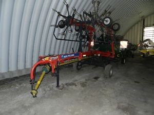

              Generally we plant a fairly high percentage alfalfa with orchard grass or Timothy. My brother has been pushing the fertilizer (P K S) to it pretty hard but the yield has definitely been worth it. Last year was an exceptional year and we got 10 Tonne/acre on first cut and 5 Tonne/ acre on the second of silage on our newer fields. We just bought a tedder to try and get dry hay. Last summer it rained every two days so most everything got chopped instead.
              I know guys around here that set all their bales, pull the net wrap, and string electric wires before the snow for grazing but we do it a little different. Two or three of us go out once a week and set enough bales for the next week and pull the wrap that way we don't use any electric string. I don't seem to have luck with fencers. Between hills, snowdrifts, moose, and grumpy cows the odds seem stacked against me. That way if you have lots of snow your bales aren't buried in a drift.
              Here's the new "tool" and hopefully we can bale instead of chopping. It makes life so much easier in more ways than one.
