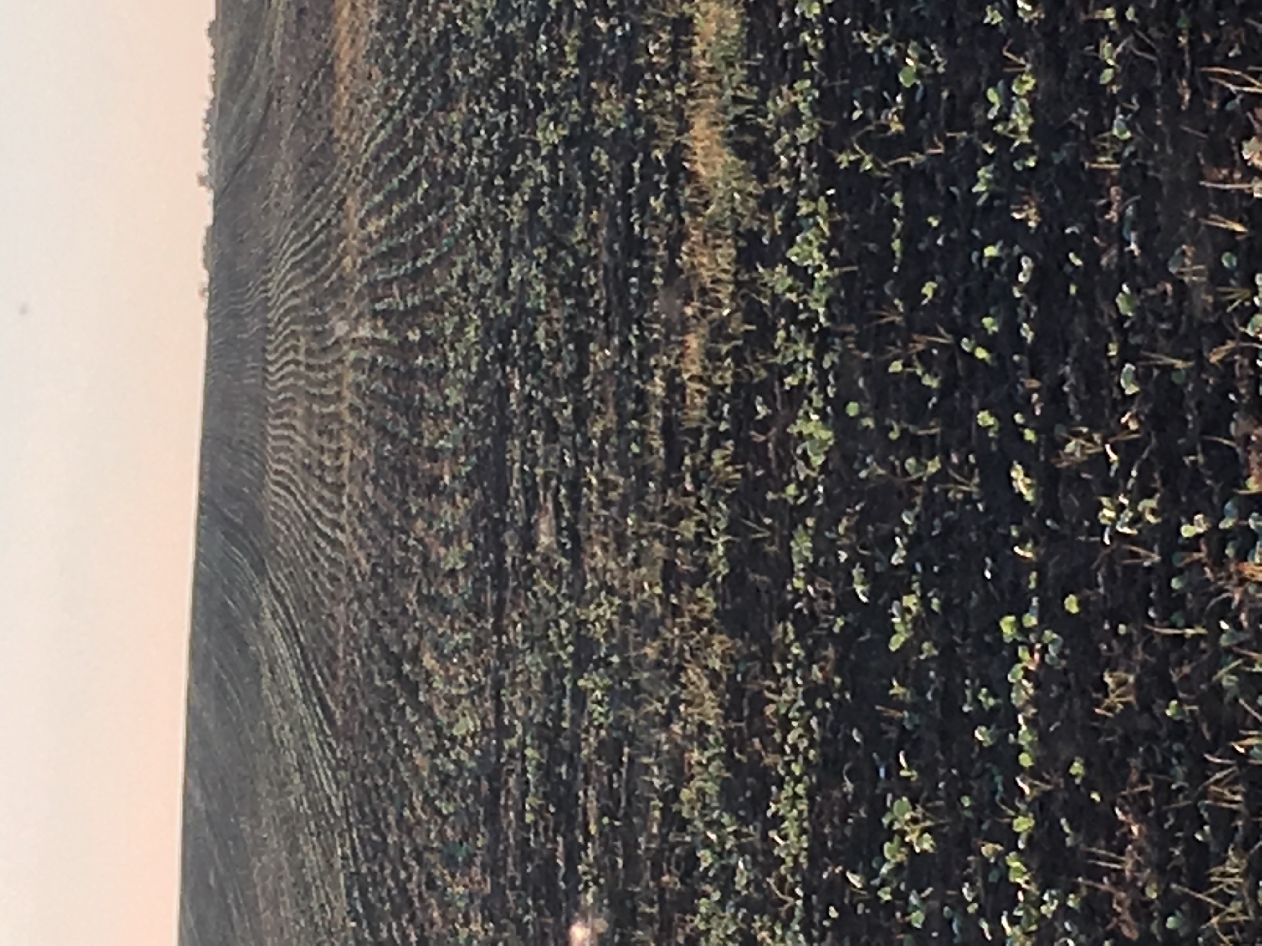

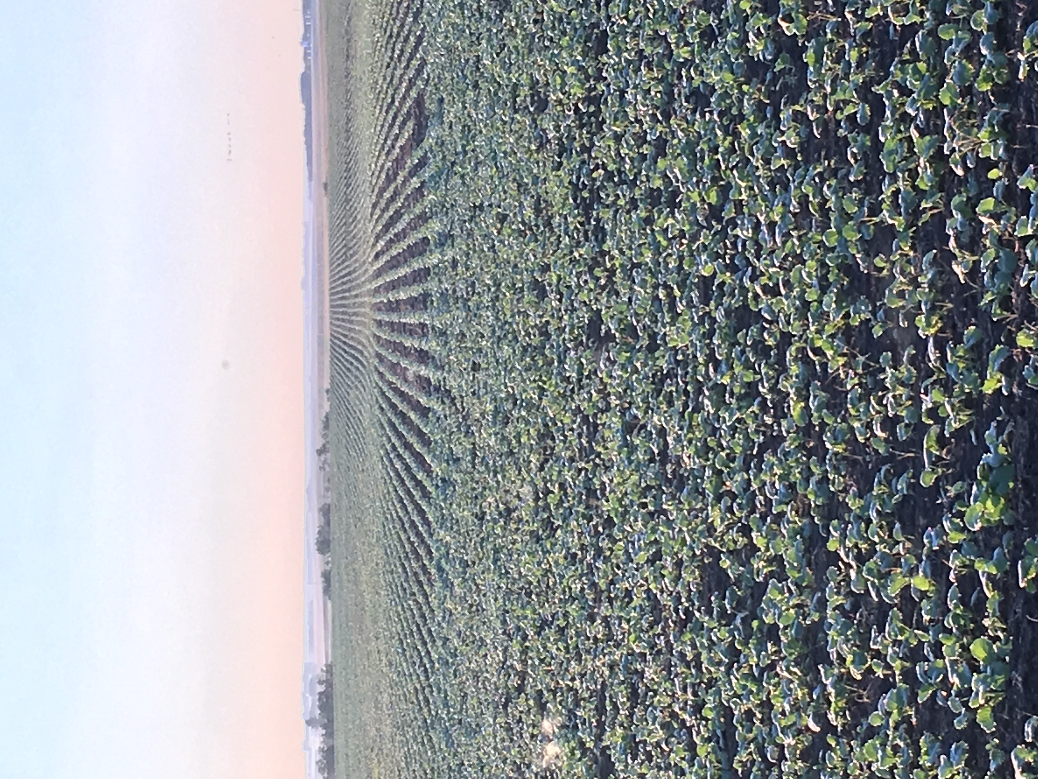

Jun 12, 2017 | 05:36 1 Quite the difference now .. seeded same day ...
45CS40 with Horsch planter at 2 lbs
45CS40 with Bourgault drill at 4.7 lbs
Granted our Bourgault is not a paralink though . Reply With Quote

Jun 12, 2017 | 06:36 3 Thanks for the pictures. Confirms the conclusion I came to last night. One neighbor calls abd I go look at his canola with him. Everywhere the tractor, cart and anhydrous tank went nice germ can see the rows perfectly. Everywhere else not so good. He rolls his canola after he seeds and uses a flexi 5000 with Dutch low draft 3.5 inch spread. Second neighbor talked to him a few days ago. Flexi 3 compartment tank same opener. Puts canola in one tank, 11-52 in one tank, urea-potash-sulfur blend in other. Puts 11-52 with seed and blend in single row between the split seed rows. Pissed right off at how poorly his canola is coming up. Anyway long story short, my thought last night was we would be farther ahead to buy a planter between the 3 of us just for canola. Your pictures tell the tale. Reply With Quote

Jun 12, 2017 | 06:42 5 nice crops ! Reply With Quote
Jun 12, 2017 | 06:45 6 I am just relieved it turned out . We were nervous to do a 1000 ac test so to speak.
This is the wheat stubble today ..
And again side by side with our Bourgault
Reply With Quote
